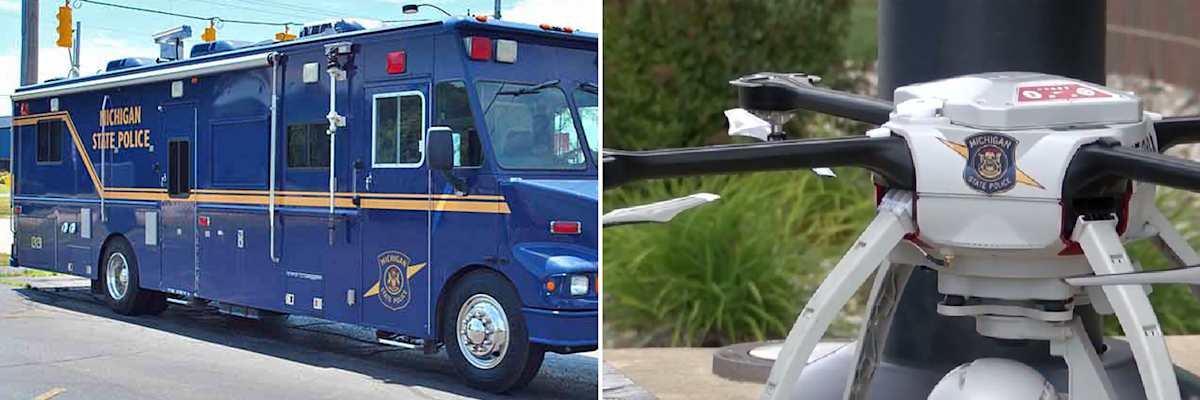

Before the event begins, the aviation unit of MSP collects imagery with a drone and hands the data off to the Emergency Management and Homeland Security Division operations management section for processing. On the ground, during the event, MSP provides radio communication support from a command vehicle.
![The MSP mobile command center truck and the Aeryon Skyranger drone that are used for surveillance](https://images.ctfassets.net/go54bjdzbrgi/1iyxdPI5Vka4G6m26QCygw/5534ba20fc1185b0209f75c0a320e35c/Truck-and-drone-for-event-security-management.jpg)

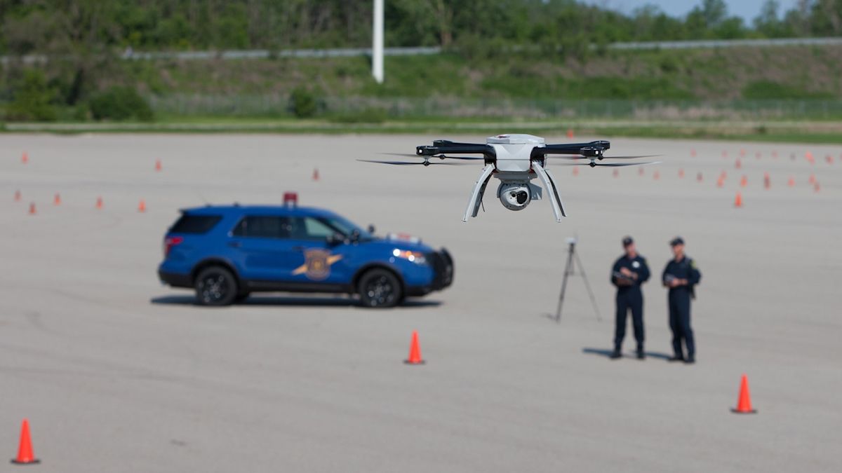

![Officers practicing in drone flight for event management](https://images.ctfassets.net/go54bjdzbrgi/dUYvuNrKXC6kS0AmcKa0K/3967b03064807405bf6d27ece4d6d7e3/Drone-flight-practising-for-event-management-by-officers-in-MSP.jpg)
“The MSP schedules its aviation assets and can, therefore, collect data close to the start of an event. The Pix4Dmapper photogrammetry software helped us produce a finely resolved and spatially accurate orthomosaic within days of an actual event.” Mr Chomentowski continues.
