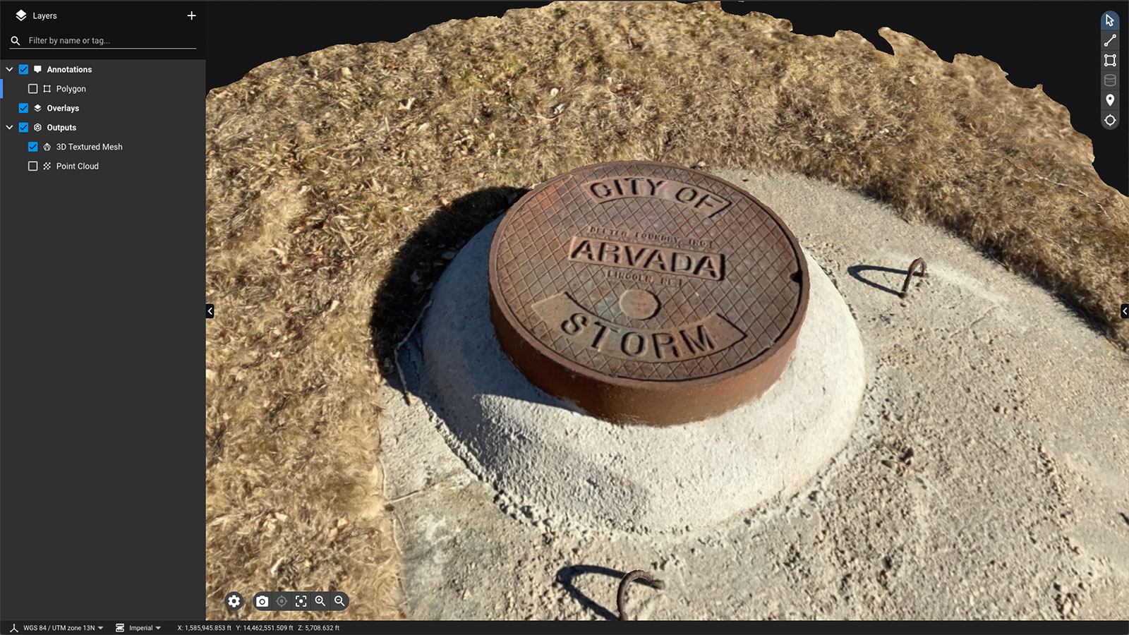

When it gets to processing, Hawkins uses either PIX4Dcloud or PIX4Dmapper.
Hawkins took 3 minutes for data collection as a practice project. He then used his phone’s mobile hotspot to send the data to PIX4Dcloud. The processing took just 20 minutes. By the time he went back home, the project was ready to use. The result was a sharp, clear model.
