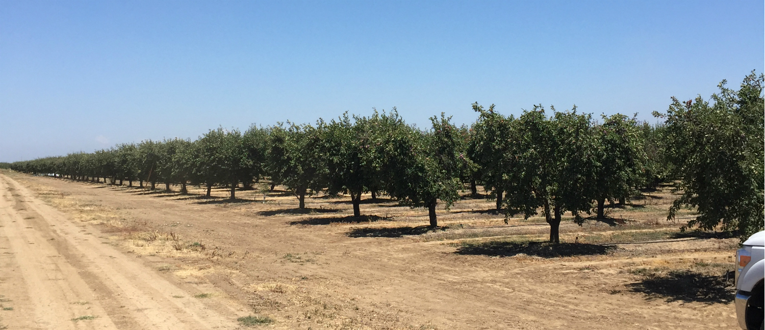

Among 31 acres of prune trees, Nicholaus the owner of PAS, and Alec the manager of the farm, shared more about the project: helping the farmer predict the overall tree health after the last foliar nitrogen application.
Foliar fertilization involves applying nutrients to plant leaves, rather than the root system, which allows growers to respond in a more precise and immediate way. This particular application was extremely important because it was the last one before the harvest, giving the fruit a final boost.

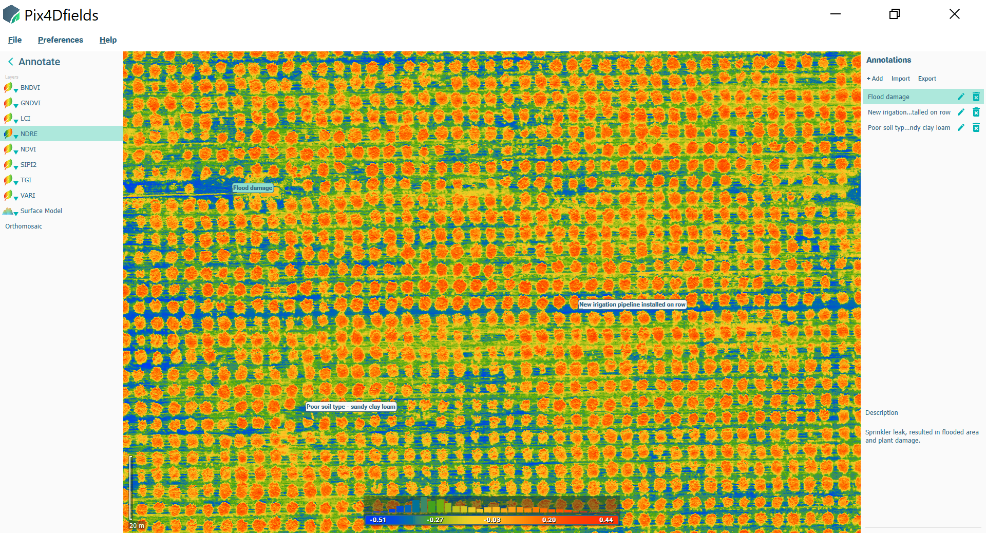

- Generate predefined index maps (NDVI & NDRE) as well as create a custom index map masking out the soil
- Use the comparison tool with the orthomosaic and the custom index to do a quick comparison of the field
- Use the zonation to create an “easy to read” map of the problems areas which he then focuses on
- Use annotations to highlight the ‘focus areas’ and adds more information to them

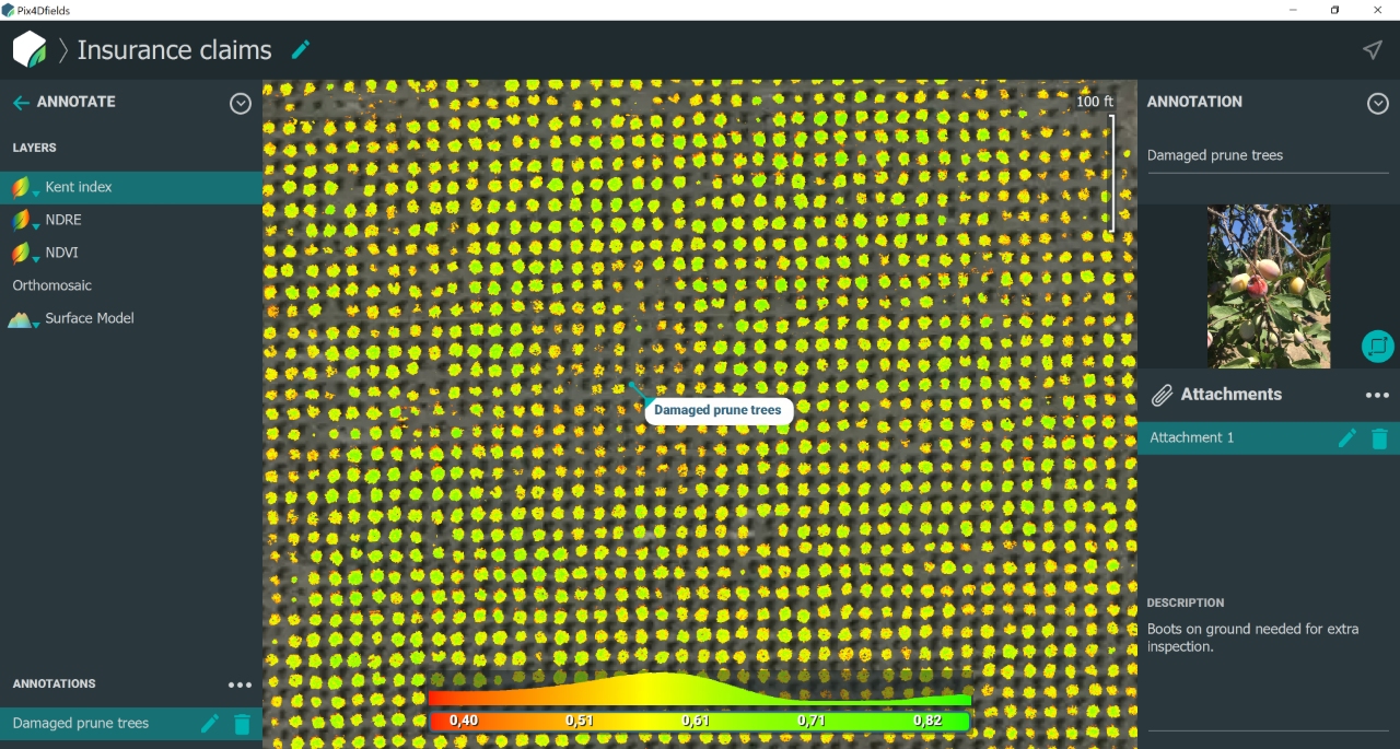

With the help of the custom index map and the annotation tool, Nicholaus highlighted potential issue areas to the Farm Manager on site.
![Custom index map created from drone images in Pix4Dfields for crop protection in agriculture](https://images.ctfassets.net/go54bjdzbrgi/5Y2X1EER4hLrgoDCvKT8XB/cc51dbafbbc70c0667566aa22850ec92/SCRN_AGR_Pix4Dfields_plums_annotations_damage_reporting.jpg)

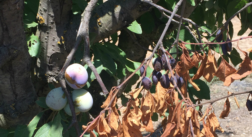

Once we arrived at the identified area we confirmed the results from the data; around 28 trees were growing less densely than their neighbors. The farmer immediately began the process of gathering soil and leaf samples to figure out what exactly is causing the issue.
With the help of the Pix4Dfields instant processing and analysis tools, PAS enabled the Farm Manager to make the timely and focused decisions on site as a part of their every day workflow.
