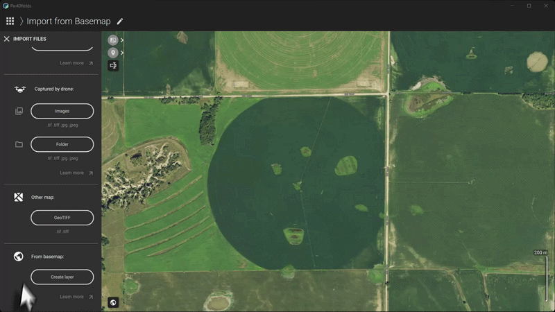

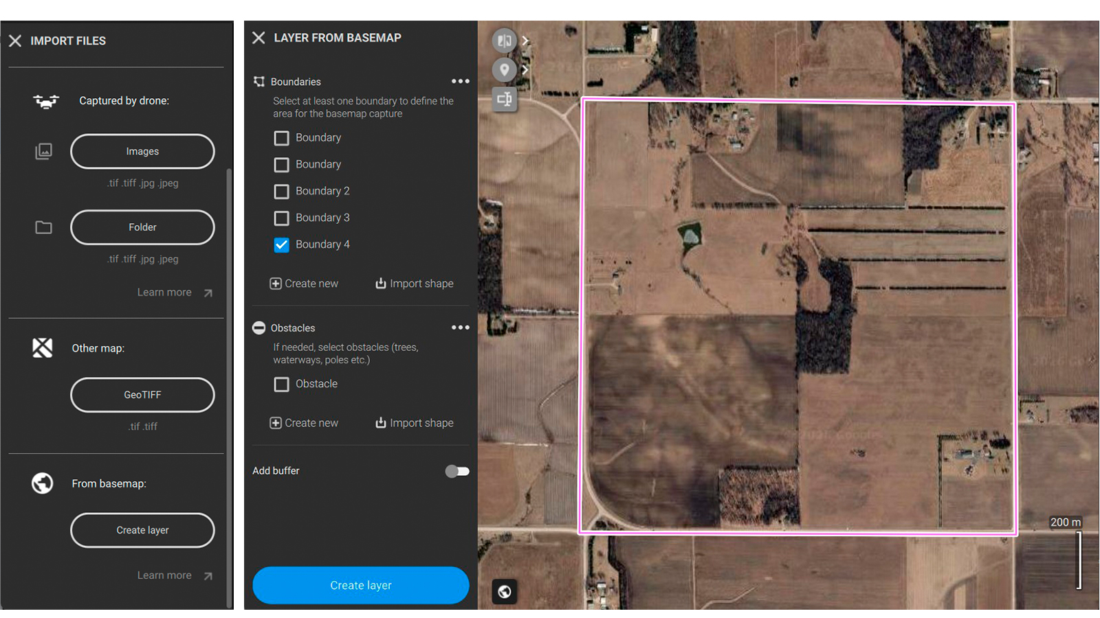

In our latest PIX4Dfields update, we’re introducing a fast, lightweight way to kickstart your project: creating layers directly from the underlying basemap.
While PIX4Dfields offers low- and high-resolution satellite imports with precise capture dates and accuracy estimates, sometimes a standard basemap is all you need for a quick, visual reference. Although it lacks precise capture dates and accuracy metrics, a standard basemap is often ideal for everyday field planning. When the on-screen view already shows what you need, this feature instantly converts it into an editable layer for creating boundaries, spray outlines, or measurements—with no added costs or waiting time.
IMG BLO AGR Pix4Dfields 2.13 1
Direct basemap layer import in PIX4Dfields
We know that when in the field, speed and convenience are what matter the most. Creating a layer directly for a basemap allows you to:
  • Prepare before going to the field: draw your annotations, mark field boundaries, and pin obstacles ahead of time so you can hit the ground running.
  • Quick spray-drone boundaries for aerial applicators: when you need to map out a quick spray boundary and high absolute precision isn't required, the basemap is often all you need to get the job done.
  • Instant estimates: need quick, rough measurements on a blank project? Create a basemap layer and start measuring in seconds.

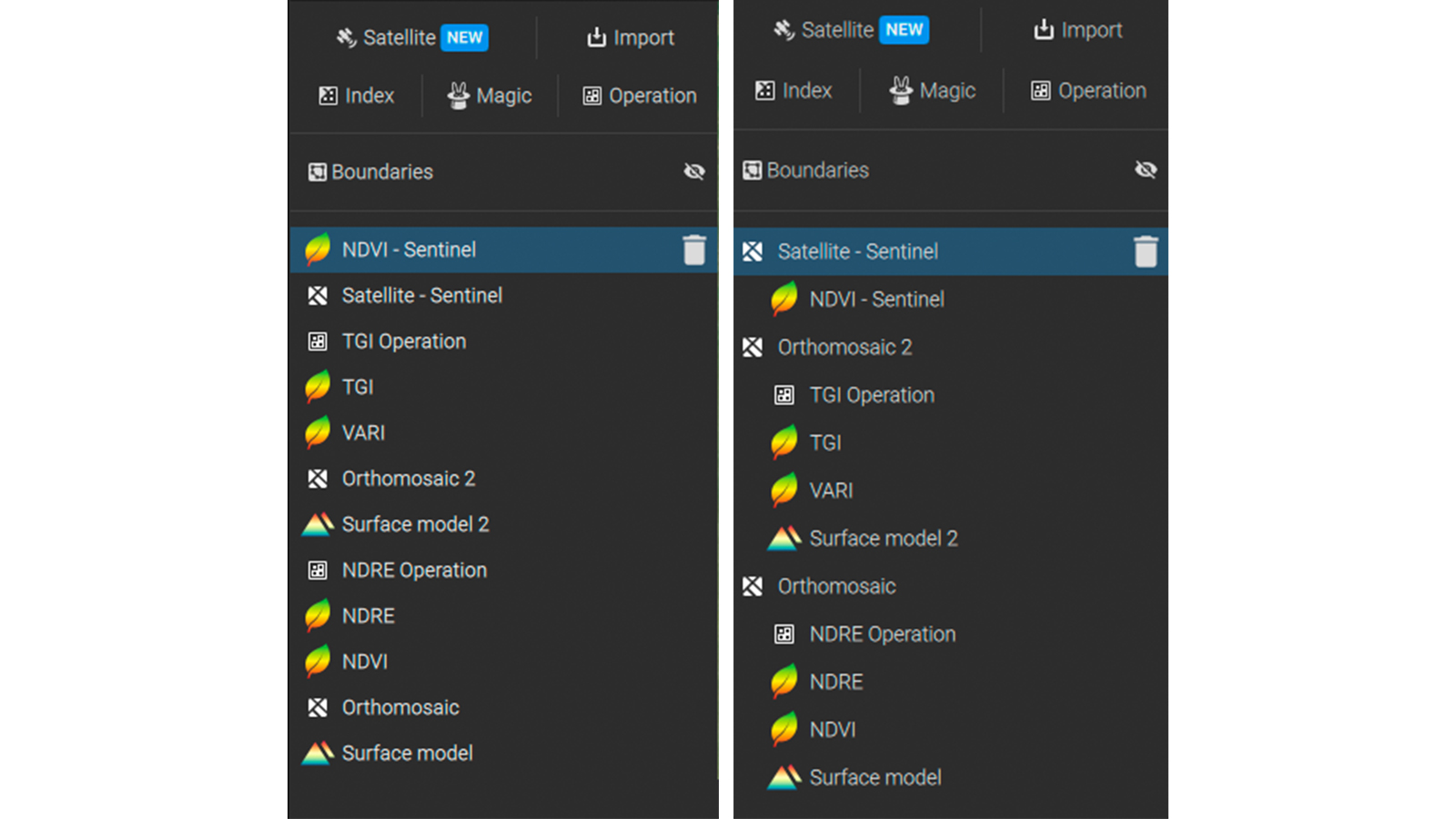

Layers originating from a single processing run are now grouped in the layer list using indentation, including generated outputs. PIX4Dfields automatically organizes your data logically, classifying all layers generated based on the layer type (vegetation index, digital surface model, prescription map, etc.). All layers are nested directly under the parent layer they came from, facilitating work especially when dealing with large projects.
IMG BLO AGR Pix4Dfields 2.13 2
Classified layers on PIX4Dfields’ sidebar before the update (left) and after (right).

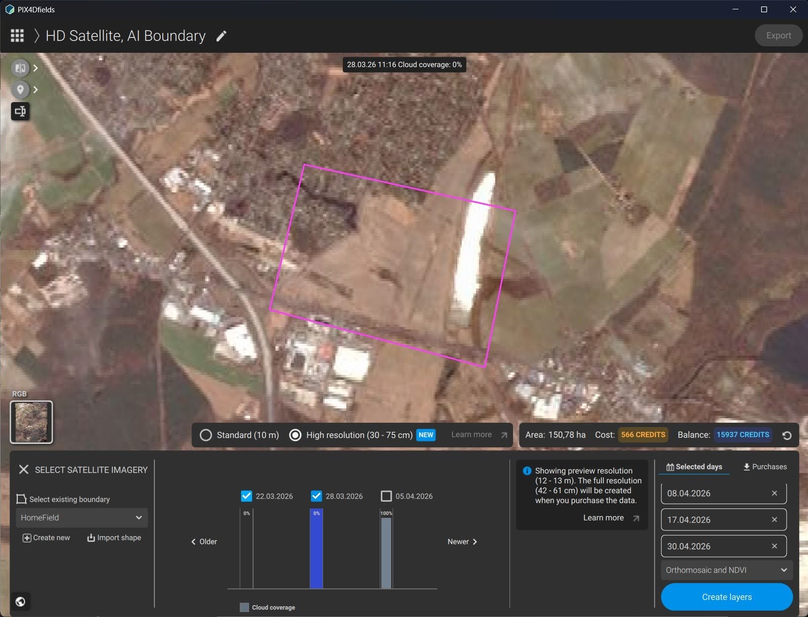

PIX4Dfields now supports the Vantor WorldView Legion constellation, increasing the general frequency of available high-resolution satellite data. The maximum size of the downloadable area is also increased, allowing users to download up to 2,000 ha of high-resolution satellite imagery with one order.
