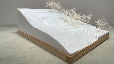

Mr. Ide: We created a model of the terrain from the data provided by Mr. Yamashita and used it to examine the architectural design. Normally, it is difficult to get an overall picture of the site at the design stage because the vegetation at the site has not yet been cut down, but the availability of highly accurate topographical data allowed us to design the site with a thorough knowledge of the topography. We were also able to identify trees that did not need to be cut down, and we were able to achieve our initial goal of minimizing the impact on the surrounding environment. When we posted about this use of topographic data on Twitter, we got asked questions from our peers. We feel that PIX4Dcatch RTK and Pix4D software are in considerable demand in the architectural design industry.

![IMA BLOG KGSS model 2 2023](https://images.ctfassets.net/go54bjdzbrgi/3zVNynPZoC1wDpmnej4ZWx/9e9c3d10e3ebfbb69fd49fb08cdf5e3c/IMA_BLOG_KGSS_model_2_2023.jpg)
